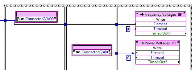

I have connected the AI to AO on the C connector of the myRIO in order to simply measure back a ramp I am creating:

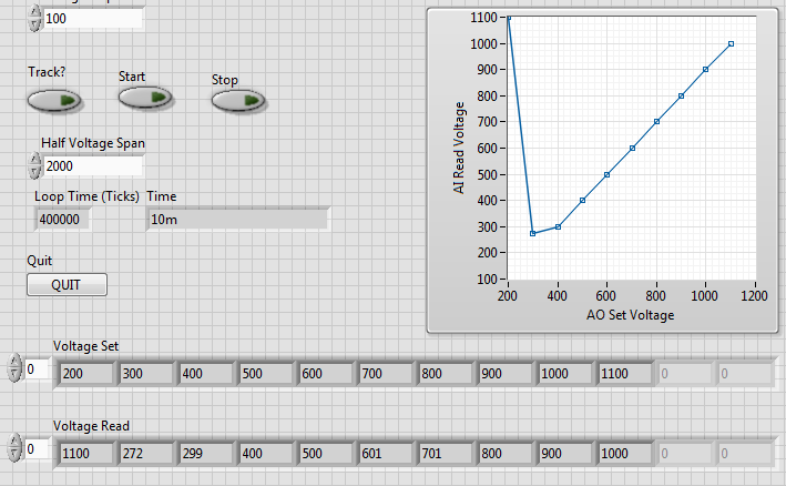

However, when I read back the voltage ramp I apply, the first value is delayed and inaccruate:

So your two arrays will be 1 reading out of sync, just how you have shown in your image - this issue will not be solved by added timing. The issue I managed to solve on my replication was where you had 272 on the reading you were expected to have 200. The first inital high reading is from the last reading of the set array - as you can see, it is essentially just one reading out.
The solution to the out of sync arrays is just to index the arrays with an offset.

hmm, re-indexing the array is a bit of a 'work-around' and as you have mentioned doesn't solve the anomolous '272'. I really don't want to add any kind of delay in here as I will be implementing some basic control based on the read signals.
