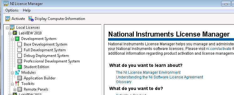

I have spoken with several experts here at NI and they want some more system information to further investigate this issue. If you could please generate a MAX Technical Support log and a screenshot of your License Manager, they will be able to better diagnose this unexpected behavior.

To create a screenshot of your License Manager:
Start Menu >> All Programs >> National Instruments >> NI License Manager
Expand the Labview 2010 tree, and take a screenshot
Please post these files and we will continue. Thanks!

I've attached the following files. Please let me know if there's anything else from my system you may need.

Thank you so much for taking the time to provide us with that additional information! After talking with several experts about your system information, we all have concluded that this error is the result of an incompatibility between Elvis 3.0.5 and LabVIEW 2010 64-bit. Even the newest Elvis drivers are not yet supported by 64-bit LabVIEW: see the notes under Operating System support on the Elvismx 4.2.3 Readme.
To fix your issue, you will need to uninstall the 64-bit version of LabVIEW and install a 32-bit version. If you are a student, you should be able to get this version from your IT person (it will work just fine with your Windows 7 64-bit OS-it will install on the 32-bit emulated OS inherent to your system). If you are not a student, please send me an individual message, and we will work with an account representative to get you the necessary version.
