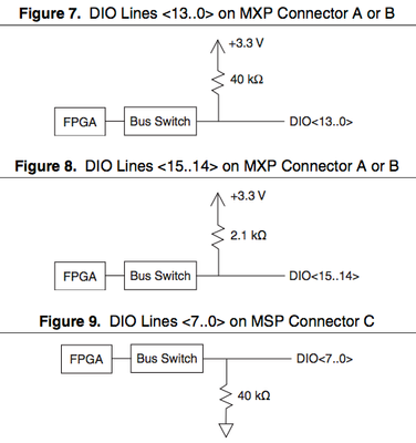

Since myRIO is a simple and compact RIO hardware and according to myRIO-1900 manual, the DIO line shows below:
Although I am not sure what the bus switch is, the DIO-line diagrams of MXP and MSP seem to be simple enough to be seem as be directly connected to FPGA. Is myRIO suitable or possible for my project which needs DIO operated at 50 MHz?
