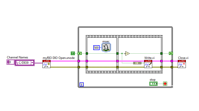

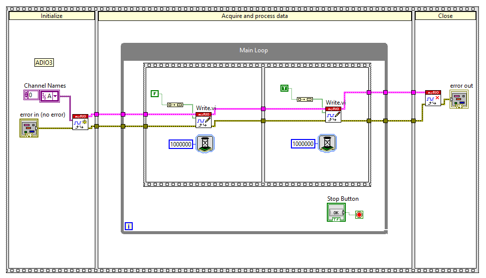

I am trying to use the low level VIs with a myRIO. Here is the block diagram with everything stripped out except the low level digital output blocks (the timing has also been modified to create one pulse every two seconds):
I know that there are easier ways to do this, but I am trying to learn how to use the low level VIs. When I run the code, everything seems to work properly (the debugger proceeds normally with no errors), but the output just stays at 3.9 volts.
Can anyone tell me what I am doing wrong? The project is attached (zipped).

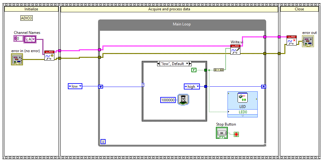

I also tried using a case structure. The LED flashes, but the output does not toggle.

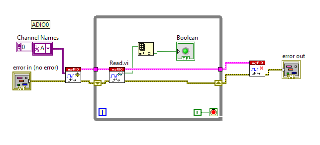

This is almost exactly like the VI shown in this video (I could not make it exactly - my version  of LabVIEW must be different).
http://www.youtube.com/watch?v=4nzr7THqU8U
The VI runs with no errors, but it always reads high from the input.

Hey there John,
Do you get the expected results using the Express VIs? What if you use the View Code option in the Express VI and copy paste that code into your program? Which port/connector are you using on the myRIO?
Daniel C.

John,
I'm not sure what could be going on here. I tried all three pieces of code that you posted and all of them worked for me. The only thing I changed was I was using the DIO ports on connector C. I know this is kind of a dumb question, but are you sure you are using the correct pins on your connector? Are you sure you have set the correct DIO lines in the program? Perhaps try the B or C connector to see if those work.
You are right in that the low level VIs perform faster than the Express VIs.
Also, for the first bit of code, here would be a better way to structure it, using the RT Wait Next Multiple VI to control the loop rate:
Daniel C.
Applications Engineer
