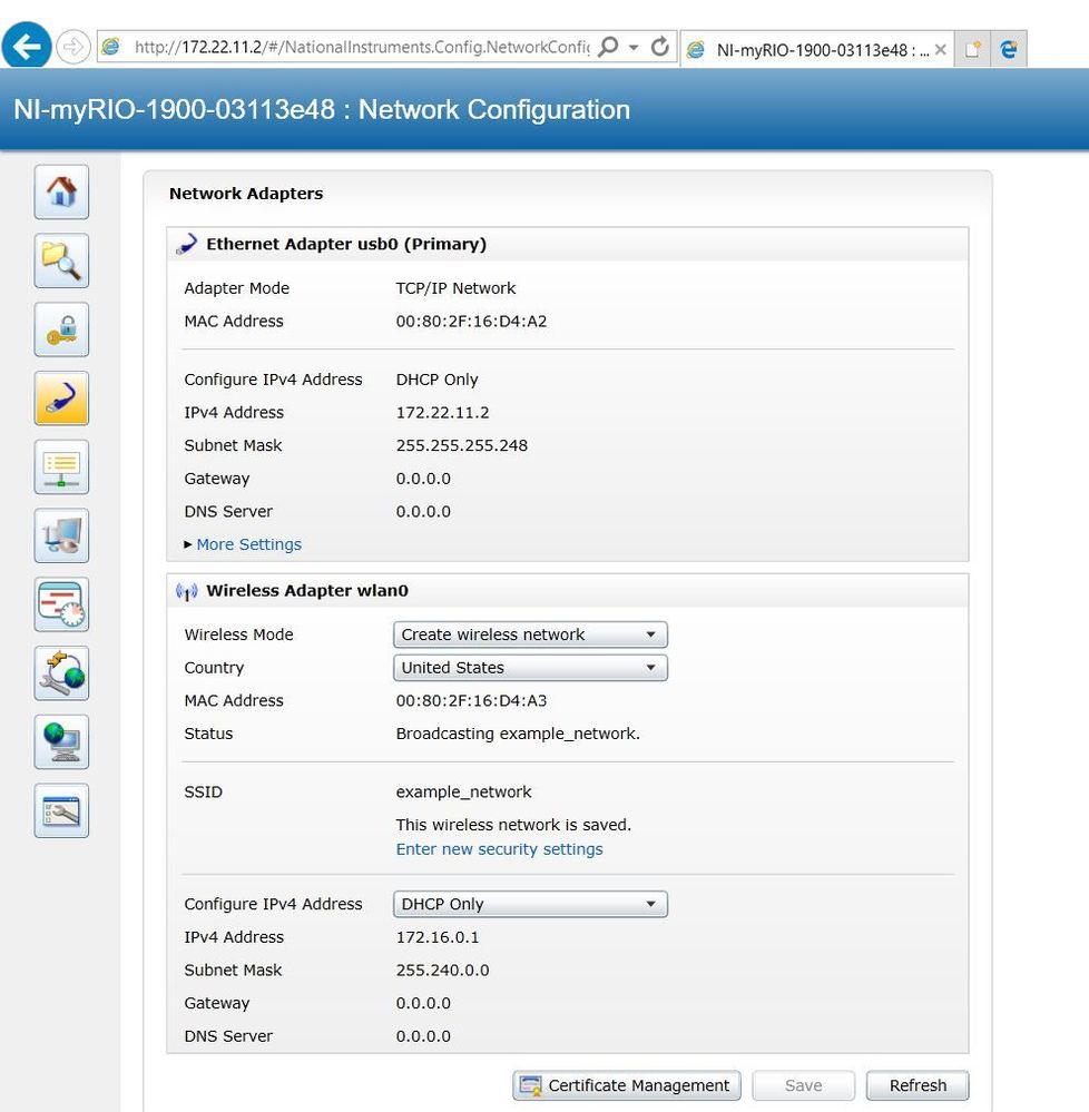

Thanks for your message! Everything appears to work just fine when I do that. I've attached a picture of an example network I just created to show what happens. Succesful_example_network_creation.JPG

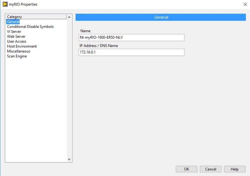

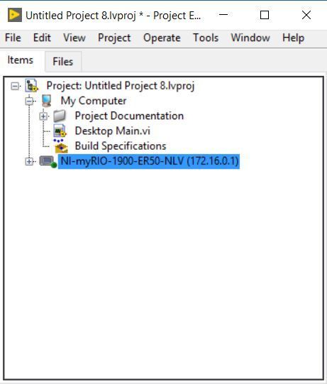

I have solved the problem. I did not change the IP address of the myRIO in the properties of the project. I have pictures attached for anyone else who may have this problem.
