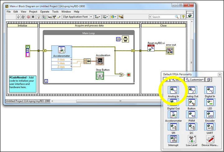

You can write programs quickly using I/O-specific Express VIs directly from the LabVIEW palette, which includes an "Analog In" function which you can use for your signal generator input:
Analog Input

Thanks for your answer. You mean that using the 'analog input' function panel directly and connect the measurement parts on the block panel? what's the difference between '1 sample analog input' and 'n sample analog input'? Also if I want to trigger the input signal, how can I do that?

Hi Johnson,
1) "You mean that using the 'analog input' function panel directly and connect the measurement parts on the block panel?"
Yes, and you will, of course, need to connect the signal generator to an analog input port on your myRIO.
2) "what's the difference between '1 sample analog input' and 'n sample analog input'?"
N Sample Analog Input allows reading multiple samples for each analog input channel at one time. 1 Sample Analog Input allows only one to be read.
3) "Also if I want to trigger the input signal, how can I do that?"
You will need to monitor a digital input. When the input goes either high or low (choose one), you start data acquisition which is performed in a loop (e.g. while loop).
