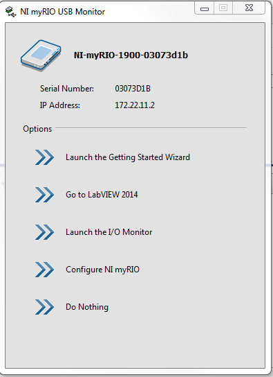

I have just got my myRIO and I have been trying to connect it to the computer ever since But I am not able to connect it.
My Computer is: Core i7, windows 7 64 bit,
  • After installing the required softwares in DVD1, I restart the system.
  •  Once I connect it, I face the popup menu with 4 options.

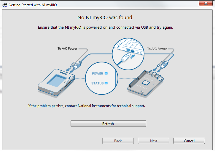

  • After clicking Launch the Getting Started Wizard, I face the following:
Kindly guide.

Does that SN match the one for the myRIO you have?  If so, it's reading it at least for that point.

That's strange.  If it's showing up under Remote Systems, that means it's being seen.  What happens if you hit Refresh on the other screen telling you it can't find the myRIO?

I actually had a similar issues the first time I hooked up myRIO. I think it fixed itself after I ran the USB monitor as administrator once but I don't remember the details. Worth a try. (close it, then right-click...run as administrator). It really made no sense at the time.

But for now, I installed it on my personal machine and it worked like a charm!

I had this problem too. In my case the firewall in Symantec Endpoint Protection had activated itself and blocked communication.
