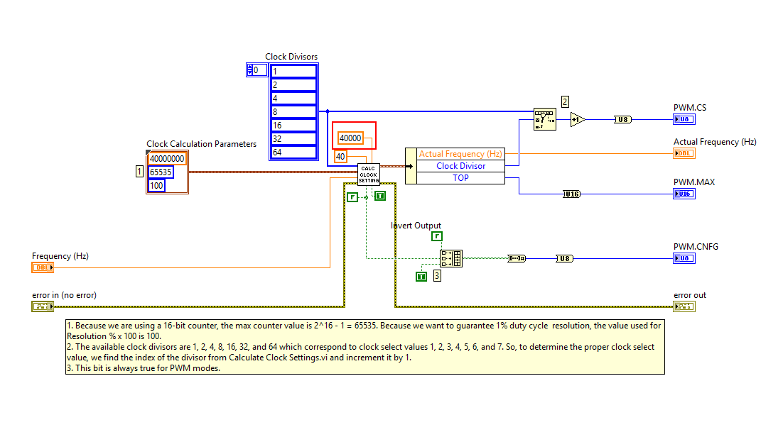

In the myRIO FPGA code there is a 16-bit counter.  It uses the 40MHz clock and supports clock dividers of 1, 2, 4, 8, 16, 32, 64. The fastest frequency you can use is when using the lowest divider (fastest clock).  The (default) myRIO software guarantees 1% duty cycle resolution, so each period is divided into 100, so the maximum output frequency the default FPGA personality can achievable is 400KHz.
However the wider the supported frequency range the harder it is to achieve specific frequencies (the frequency resolution is reduced).  So a design decision was made to support 40Hz - 40KHz to provide a wide range of frequencies while still being able to accurately achieve the user specified frequency.  This is evident when you click the validate frequency button in the myRIO express VI.  It takes your target frequency and tells you what frequency it can actually produce.
You can try the following to get a wider range of PWM frequencies (fair warning I haven't tried this so you might want to back up the myRIO VIs before you change anything.)
For the myRIO-1900:
Open <LabVIEW>\vi.lib\myRIO\Common\Instrument Driver Framework\myRIO v1.0\PWM\vis\myRIO v1.0 Generate Register Values PWM.vi
Change the Max Frequency constant (shown below) to something greater than 40KHz (but less than 400KHz).  Save the VI.
Try your myRIO code again, with a PWM frequency greater than 40KHz.  The Express VIs might prevent you from using higher frequencies, but if they do you can just switch to the Advanced IO VIs...they'll let you do whatever you want Smiley Happy
Let us know if that works and remember, your PWM frequencies might be less accurate as a result.
-Sam K

You should be able to increase the PWM freqeuncy beyond 40KHz by modifying the VI as described above without using LabVIEw FPGA.  The VI is part of the myRIO Module and can be found at:
