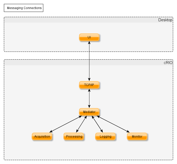

I had a thought on this but tell me if I'm way off base. I could have one actor launch the others. This way that top level actor would have two way communication with the other actors. When the actors needed to communicate between each other, they could pass their message to the top level actor who could then distribute the messages to the correct actors accordingly

I had a thought on this but tell me if I'm way off base. I could have one actor launch the others. This way that top level actor would have two way communication with the other actors. When the actors needed to communicate between each other, they could pass their message to the top level actor who could then distribute the messages to the correct actors accordingly.
Nope, you're not way off base.  This is "hierarchical messaging" (HM) and I do it all the time.  It promotes reuse and testability by limiting the dependencies between various actors.**  In the diagram below, all the cRIO actors except the Mediator can (if you take care in your coding) be copied and used in other projects as is.  I also think it is much, much easier to look at the code and understand what is happening when HM is used compared to observer based messaging where each actor sends messages directly to the destination actor.
Of course there are tradeoffs.  For example, in HM when a message has to be delivered across a large messaging tree, each actor along the way has to repackage the message for the next actor in the line.  It's not difficult, but it can be tedious.
**[My understanding of the early versions of the AF was all messages were "input" messages.  That is, in order to send a message to another actor you had to call a Msg.Send method written specifically for that actor.  In the HM system below, the Acquisition actor will have the Mediator message's custom Send methods in its source code, making Acquisition statically dependent on Mediator.  Obviously this limits our ability to easily reuse the Acquisition actor.  One way to break that dependency is for the Acquisition actor needs to have self-defined "output" messages which Mediator will catch and process according to you application's specific requirements.  I believe the current AF version has a way to break that two-way dependency, but I haven't worked with it enough to tell you how to do it.  Hopefully somebody else will chip in.]
