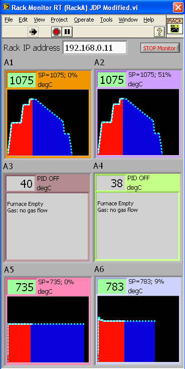

Goal: Automated banks of multiple high-temperature furnaces.
Details: several racks of multiple high-temperature furnaces are controlled by Real-Time controllers (Thermocouple inputs, heater outputs, etc.).  Users, on a nearby desktop, configure individual furnaces to perform set temperature profiles, lasting from 8 hours to 30 days in duration, and record data throughout (data interval of 5 seconds).  Actors (one main actor for each furnace) will run these profiles.
Network Topology and Security: Local net between one or more desktop computers that run a UI and several Real-Time controllers.  Security is handled by having all desktops and Real Time Controllers behind a Firewall Router (they are all in the same locked room), so extra security is not required.
Error Behavior:  Intermitant loss of the User Interface(s) expected (Windows desktops don't run for weeks or months reliably).  Furnace Actors must continue regardless of UI contact, and must seamlessly allow a newly restarted UI to reestablish control.  Thus, all configuration information and data needs to be kept on the Real-Time controllers.  When reconnecting, the UIs must be be sent this information so that it can provide the proper display.
Anything Additional Aristos Queue Needs To Know About Requirements:  Final results need to be uploaded to a database.  This can only be done from the desktop machines, not the Real Time units, meaning that there must be a final message containing a potentially large amount of data.  If no UI is online when a profile finishes, the Furnace actor should wait until a UI desktop is available (actually, perhaps there should be a separate "Upload Actor" that the Furnace Actor remote launches on the Desktop machine).  Multiple UIs are desirable, but not strictly necessary.
This project was done a few years ago using large numbers of Shared Variables.  Below is a current image of it running (one rack of 6 furnaces; the four of them are midway through temperature profiles of between 14 and 22 days; UI computer is rebooted weekly).  If I were doing this again, I would use my home-grown Actor system and TCP message passing instead of all the Shared Variables.
