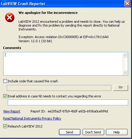

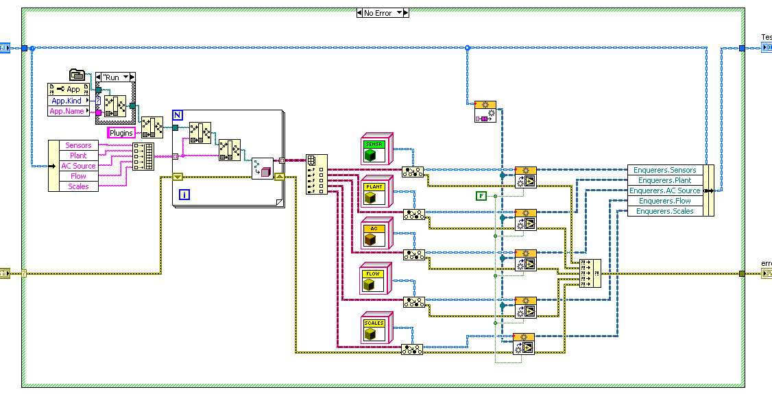

I've got a really frustrating problem at the moment with my project.  For some reason when I launch a set of my actors using the code below LabVIEW crashes straightaway.  The strange thing is it didn't use to do it, it was working fine, and there are no errors in the error list.
I've checked through all the Actor Core.vi files in the actors to make sure they aren't corrupted or anything, they all open fine.
Has anyone got any idea what might be causing this please? I can't see how to progress as it all seems fine.  I've tried just launching one of the actors, all combinations but it happens anyway. I'm running 2012 SP1.
