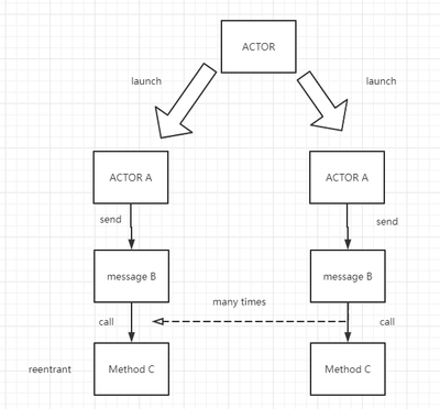

Hi all,i got a problem which is not found in the discunssions before,so pls give me a tip :
The message is in a loop ,read client 's request .
I  built a actor , launch two times to do the same thing but face to different client , just like a framework ;
Launch one time works well , but two times works bad .
I debug the vis , found the message B(right) call the Method C (left) , not  call  the Method C (right) . I have already made the Method C reentrant.
Did i do something wrong?
THKS!

How do you distinguish between the "right" and the "wrong" method C? Are you sure that you are sending the Msg to the correct enqueer?

Thank you for reply.
I used the "LabVIEW Task Manager" , open the method C (left and right in the picture ) .
The left method C  got the requests from client , but the right method C got request sometimes , most request were sent to the left method C 。
