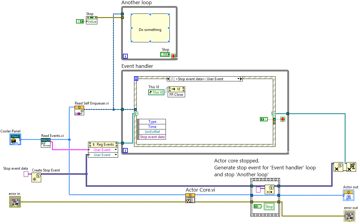

The Actor Core is running its own while loop de-queuing messages that are sent to it. From what I can see of your current set-up, the parent Actor Core won’t start running until your state machine loop has stopped.
Typically the parent Actor Core is run in parallel to your own custom loops. When a stop message is received by the parent Actor Core the loop stops. Use this to close the parallel loops:

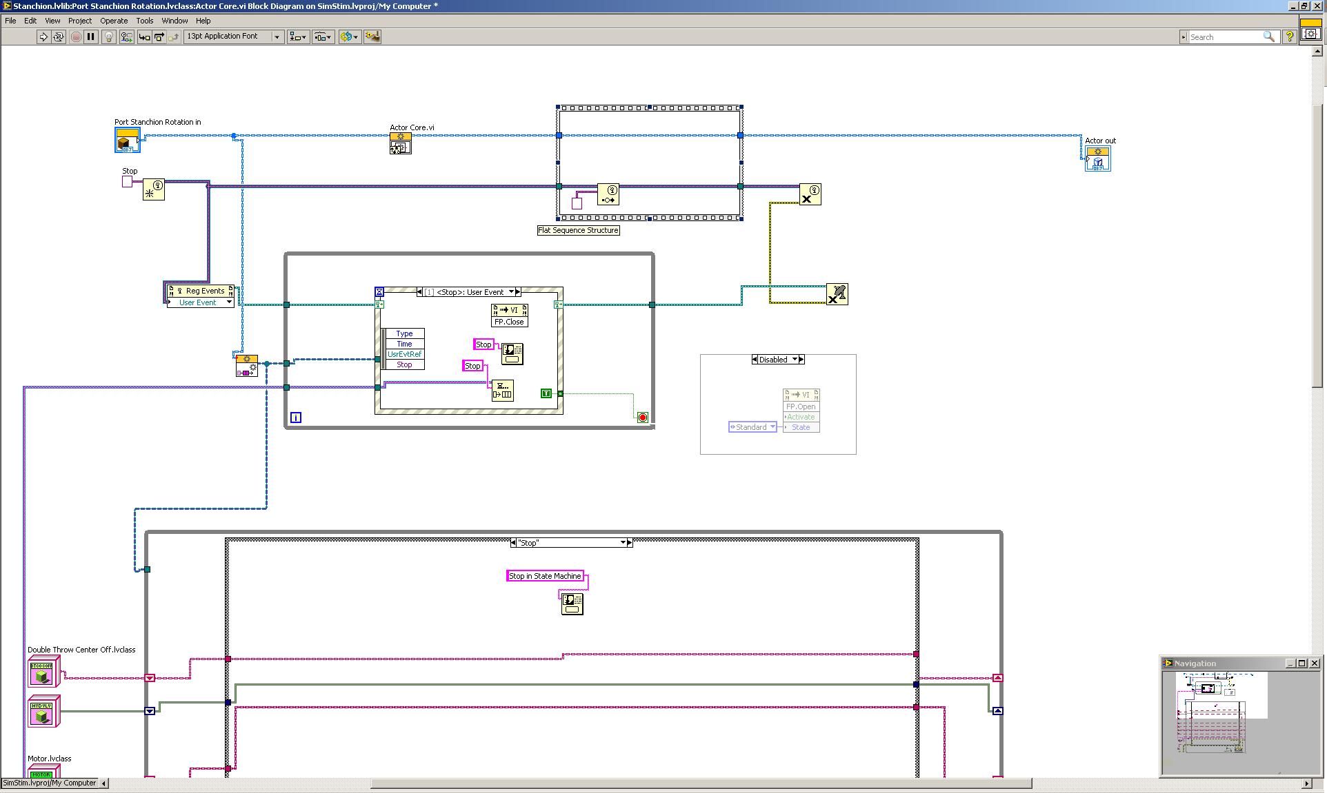

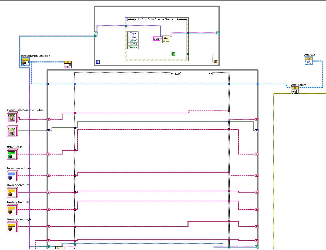

actorCore_stop2.JPGAlright, I am a belie-ber in your words, and recognize that I need to implement them (especially, since I went back to the documentation and saw that it specifically called out to make sure I am running my ActorCore code is in parallel with the Call Parent VI).
Create a set of user events to manage your front panel updates. Create these events in your Actor Core.vi and bundle them into the actor object prior to invoking the Call Parent node. Then create a loop in your Actor Core.vi that runs in parallel to the Call Parent node which is dynamically registered for the events. When the actor receives a message, the handling function for that message can generate the appropriate event and pass along any relevant data. Alternatively, you may choose to use queues, notifiers, or other mechanisms to communicate with your parallel loop rather than events. Regardless of which mechanism you prefer, National Instruments recommends that you select only one data transfer mechanism within any given actor, and keep the total number of such mechanisms to a minimum within the application as a whole. Be sure to provide a mechanism to stop your parallel loop and trigger that mechanism by overriding Stop Core.vi in your actor child class.
How do I provide the mechanism for the loop to stop?  I can't just send a STOP string, nor can I use the STOP button at a higher level to send the STOP command to a lower level directly.....Can I?
Edit:  Okay, I was able to get my actor to stop by making sure the Call Parent Method was parallel to my process, adding an Event, and then sending a message to my QMH queue.
