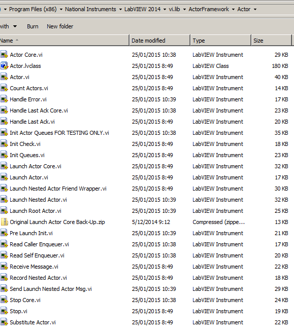

You can still use it:
PS: Don't mind the back-up I made. It was for some support reasons.
