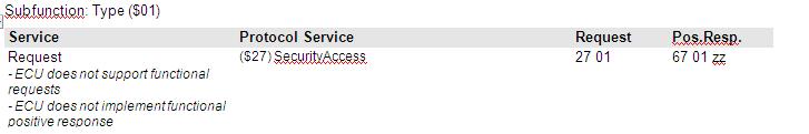

Client requests seed > Server sends seed > Client sends key based on seed > Server responds with unlock succeess and unlocks services

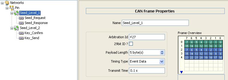

Based on this information, I have created a CAN Cluster with two frames and 2 signals on each as shown. The Seed_Request signal is made up of 2 bytes, the Seed_Response is 3 bytes & vice-versa on the key commands.
However, I do not get a response and I'm not even sure if I have it set up to properly get any kind of response. I believe my arbitration ID is set based on the $27 but I do not know for sure. I have also attempted to use the NI-XNET Bus Monitor to 'Transmit Single Frame', but I do not receive anything in the Bus monitor/ID Logger/Statistics (i'm not sure if it would go here even). For better troubleshooting, I have both ports hooked up in parallel and can see the signal i send using both the receive single frame and send single frame vi's, but never see a response from my device. I know that i have proper settings for baud rate (500K), termination on (no physical 120 ohm resistors on cable), high speed, and standard id length (not extended)

Maybe you have this figured out already, but it looks like you're working with the UDS protocol on CAN.  $27 is not the arbitration id, it's the "service request" id, the first data byte of the frame you transmit; the arbitration id you should use is the "segmented request" id specified by the manufacturer of the motorcycle.  The response will be on the "segmented response" id specified by the manufacturer, and the first data byte of the response frame will be $67.  These numbers are hex, by the way.
