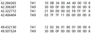

Packet monitoring is as follows:
Problem 1: The message shows that THE ECU rejected Tester's request 34, but according to the message, data can be transmitted. It is not clear why the rejection is 7F 11 solution.
Problem 2: The block 1 data transmission packet is not displayed. The error code is "8257" (the transport layer receives out-of-order frames), but the start address of the second block is based on the size of the block 1 data. The second block of data transmission is not complete, the error is reported because the receiving flow control frame timeout.

Okay lets try this one at a time
10 0B 34 00 44 40 00 10
This is saying: I have 0d11 bytes of data to send you, the first 6 bytes are 34 00 44 40 00 10.
The ECU then replies with: 30 00 0F
This is saying I'm ready to get the rest of the data from you, send as many frames as you want, but they need to be separated by 16 ms.
Then you send the remaining bytes which are: 21 00 00 00.  There are more but we said we were only sending 0xB bytes (0d11) and since we already sent 6, we only need to send another 5.
The ECU then replies with a negative response.  I think it is either saying "Service not supported in active session" or "Service not supported".  Is your ECU in the programming session?  Does it need to be unlocked with a Seed/Key?  Most ECUs won't let you program them unless they are in programming, and after going into programming most need an unlock routine.
After that I do still see another issue.
10 FA 36 02 54 00 07 B8
If this is the first frame in a series of them, then we are saying we have 0xFA bytes (0d250) to send, and the first 6 is 36 02 54 00 07 B8.  The next step is to wait for the flow control message telling us how many to send, and what kind of delay we should have.  But instead I see it starts sending data 7 bytes at a time.  Each frame that starts with a 0x2[0-F].  Later there is the 30 08 0F which tells us you can only send 8 frames at a time, with a 16ms wait between them.  Looking at the state machine for the ISO-15765, after we send a first frame, we should then go to the reading state looking for that flow control.  We shouldn't send more data until we get that flow control.
