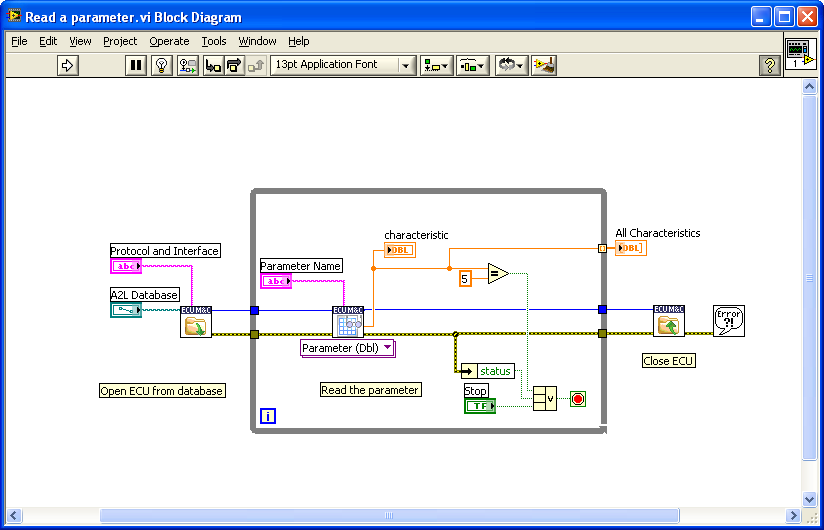

I don't think you need the connect.vi inside your loop.  Once you established the connection with the ECU (outside your loop), you should be able to read the characteristic.  The only other detail I can see is that you are using local variables inside your while loop for the ECUref.  You should just wire the output of your connect (the one outside your loop) to the read (in your loop).  So, 2 modifications:
1.  Delete the connect VI from inside the loop
2.  Connect the ECUref directly from the connect outside the loop to the read inside the loop.
I modified one of the shipping examples that you can also try.  I hope this helps.

Thanks for reply and for the example!
Unfotunatelly this does not solve my problem.
Reading a CCP right after power on gaves me the value 0 instead of let's say 5 (which I'm sure it is because I can read it with another internal tool). Somehow it seems that these first samples are surpressed and changed with 0. After some short time the CCP are read ok but the time for the values which I'm intersted in is elapsed.
Any other Idea how to read these "initialization" values?
