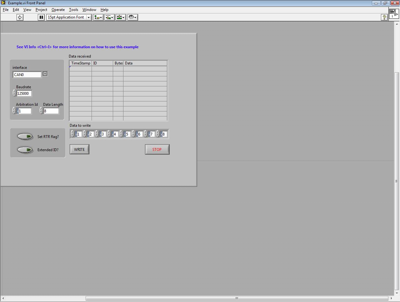

Kindly attached this example in Labview 7.1.
Message 3 of 13
(18,660 Views)
    I am attaching the screenshot of the VI. Hope it works in 7.1. Else upgrade LabVIEW.
