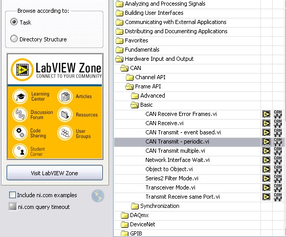

Hey FlamingYawn,
Have you had a chance to try the periodic transmit VI in the example finder?
Nick D.
Message Edited by Nick D on 06-11-2007 08:22 PM
Message 8 of 9
(6,085 Views)
Thanks for chiming in, Nick, but I'm using the Channel API and would like to stick with it.  Any other ideas, guys?  Am I simply overloading the NI CAN card?  When I tested just the 62.5 Hz singals, they were all right on the money.
