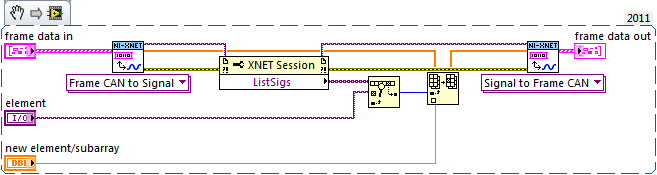

As for the issue of modifying a single signal and retransmitting, would something like this not work?

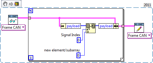

4. Is there an easy way to replace signal data within a frame that already contains data?
Use the XNET Frame to Channel and Channel to Frame conversion libraries.  After a little more digging into the XNET API, it seems the following snippet would accomplish replacing a signal using the XNET API:
