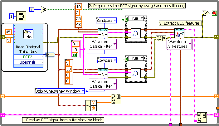

When I change the path of the example - ECG Feature Extractor, and set the start to 45s, it works for finding each heartbeat by default settings. If you would like to detect more waveform features, you need to adjust the feature extractor VI parameters. :
