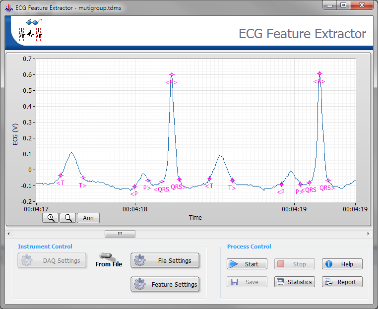

What's your purpose of template matching? From the paper, I see the purpose is to identify the ECG beat with fidicial point. If that is your objective, Biomedical Toolkit provides a reliable feature extraction VI for you to do this.
Check out this https://forums.ni.com/t5/Biomedical-User-Group-Documents/How-to-Use-the-New-ECG-Feature-Extractor-Ve... and https://forums.ni.com/t5/Biomedical-User-Group-Documents/How-to-write-an-ECG-feature-extractor-with-...

I think it is definitely doable for your steps in LabVIEW.  But besides collect signal from leads (via DAQmx or other way) and detect fiducial points in one lead, there are no existing VIs for other steps in LabVIEW or addon toolkit. You need to write VIs on your own.
https://decibel.ni.com/content/servlet/JiveServlet/showImage/102-29035-3-69009/Main.PNG
