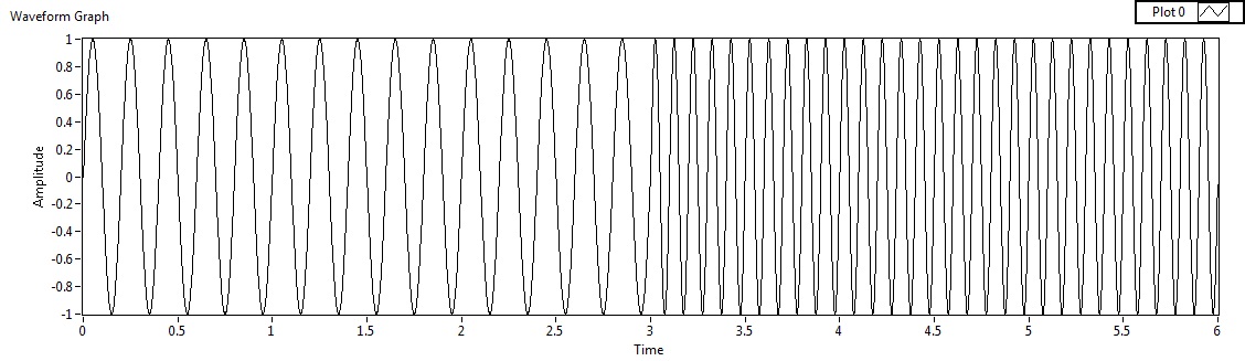

and know i have 2 signals with 2 frequencies and 2 times .
5 Hz , 3 second and 10 Hz , 3 second ,,

i'm so sorry for bodering you .but can i have 3 or more frequncies in a signal ?
with appended waveform i can have 2 freqiencies in a signal
Message 9 of 10
(5,147 Views)
Take your appended signal with two frequencies in it and append another signal to that.  Now you have three signals.  Repeat as needed .
