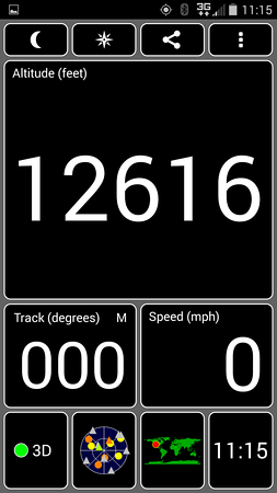

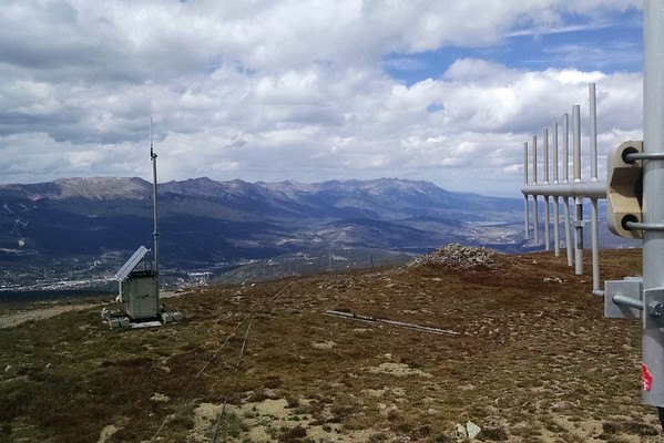

One of the radio sites I work with is on top of a mountain (12,600ft).  Utility service up there is unreliable to say the least (measure 90-100v at the plug... little bit of loss in that cable running up the mountain!).  Solar works most of the time, but if  there's any snow on the panels it doesn't take long for the system voltage to drop low enough that the equipment starts backing off power or shutting down.  Need to head back up there sometime... analog link has some issues.  Digital and IP's running great though, and that's the system I deal with. Smiley Wink
