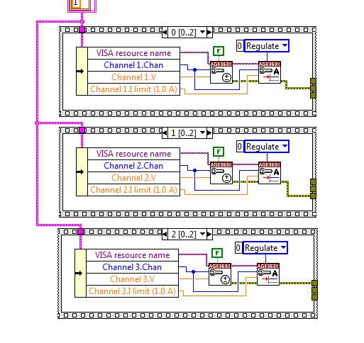

I used a stacked sequence today. So sue me.

Just curious, why not wrap the two functions into one (such as "init" or "setup" or whatever). Then have an array of clusters, one cluster  array element per channel, then have said function called in a for loop.
And don't forget to propagate the error cluster between cases with the shift register.

There is absolutely nothing wrong with stacked sequences. In fact I use them in a central part of my most advanced code where they provide the cleanest solution.
(two frames, each frame needs the same inputs, only the last frame outputs something, no sequence locals)
However, if abused, they an easily lead to the most unreadable am unmaintainable code, especially if sequence locals are involved and there are many frames.
Yes there is. As soon as you need to pass data between frames you're dealing with sequence locals, which are just the worst.
