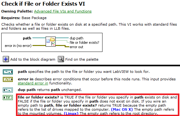

@for(imstuck) wrote:
file or folder exists returns TRUE on an empty path.
As documented. 😉

"Is there some computing reason for this?"
As documented. 😉
I guess that answers that.
Message 102 of 139
(11,318 Views)
Now, whether or not an empty path *should* refer to the mounted drives of the system is certainly a valid question. But currently, that's how all the File I/O functions and VIs treat an empty path.
Message 103 of 139
(11,314 Views)
I can say from my experience today, it's counter intuitive. But maybe it's not for someone with more of a computing background. I guess the fact that it's documented is fine, but it certainly could bite someone whether it's mentioned in the help or not. My initial thought when I saw this behavior wasn't to go look in the help.

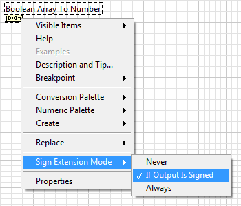

@JÞB wrote:
On a related note:
I'm pretty sure I looked through the help.... I did not find a suitable explaination for this Right Click option ....
It seems like minutia that will bite visciously if angered.
Has anyone trained this dog to do tricks?
Were you actually looking for an explanation of this? Let's say you wire a 12-element array of booleans, with the output configured as 16 bits (because it needs to be a whole number of bytes). The data will be in the low 12 bits. What should the upper 4 bits contain? If the sign extension mode is "Never" then those upper 4 bits are 0. If the Sign Extension Mode is Always, then the upper 4 bits are set to the same value as the last element of the array. If Sign Extension Mode is "If Output is Signed" then it will act like "Never" when the output configuration is unsigned, and "Always" when the output configuration is signed.
