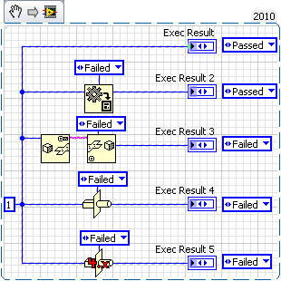

Casting an int to an Enum (strict).
Who thought it would be so tricky?  Turns out that although I had expected each of the last 4 methods to be functionally equvellent I was wrong.
I guess you really do learn something new every day.

Make that constant into a U16 and Bob will be your uncle.

This NI document explains typecasting an integer into an enum.

Just when I thought I knew something about LabVIEW!
Thanks Jim!  I wondered WHY- now I know.

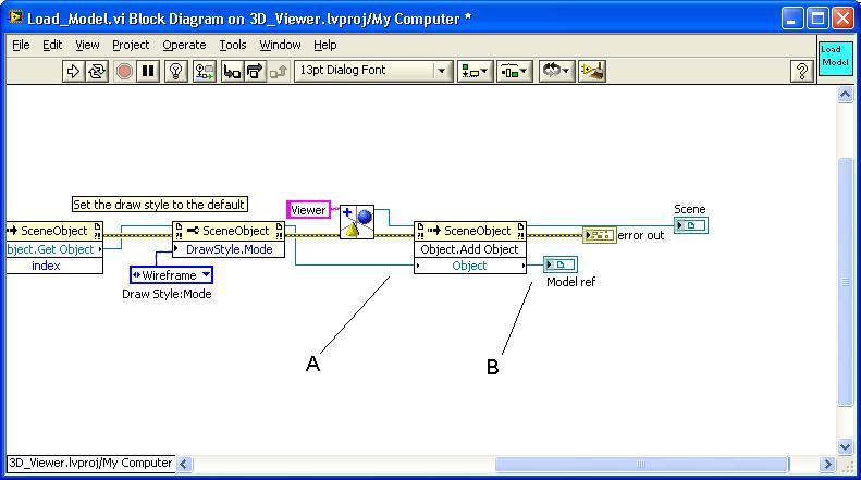

When working with the 3D Graph in the 3D Picture, I got bit.
A is not equal to B
Since I cut-n-pasted from an example I ASSumed that the wire was run behind the structure and worked with the value from "A" right up until I tested it.
Please note the tiny arrows indicating an Input AND an Output.
Can anyone else recall seeing another one these anywhere else?
