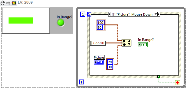

This piece of code checks whether the click was inside the green rectangle:
Looks nice and simple, doesn't it? If the click is between 20 and 100 X and 30 and 50 Y, you're inside the rectangle. Great.
The only problem is that it's wrong. Clicking under the rectangle returns T, even though we're not in the rectangle.
You see, the In Range & Coerce primitive is set to the Compare Aggregates mode, because I figured that just means that LabVIEW takes the results of all the comparisons in the clusters and ANDs them, providing a nice, clean way of easily comparing an entire array or cluster. Turns out I was wrong. That's not what Compare Aggregates does.
What it actually does is to compare the elements in order, similar to what happens in a dictionary or a phone book. When we do an equality comparison, this is actually the same as ANDing the results, but if we do a greater-than or other inequality comparisons, it isn't.
As an example, consider the following - in a phone book, is "Smith, John" greater than "Smith, Jane"?
The answer is determined by comparing characters until we find the first character which doesn't match. In this case that would be "a" and "o". Since "o" is greater, John is greater than Jane. If John was called Doe instead of Smith, he would not have been greater than Jane, because "D" is not greater than "S".
Looking at it like this, this piece of code is similar to asking whether BR is greater than AZ. Since B is greater than A, we don't even need to check the second letter. Likewise, in the example above, clicking below the rectangle returns T, because the value is between 20 and 100 X.

The compare aggregates mode is naturally tied to the method LV uses to sort arrays of clusters (both are based on the implementation of the comparison operators).  That In Range function will simply check that the three clusters are "sorted".  Someday I may find a use for that, have not so far.
Change to Compare Elements, slap on a Cluster to Array and And Array elements and you have a nicer implementation of Point in Rect than the one in vi.lib.
