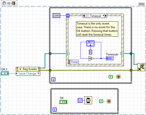

If an event structure is registered for an event but does not have a case for that event then firing that event will still reset the timeout timer for the structure.
Some people consider it a bug and others consider it to be expected behavior.
There is an interesting debate on Lava about this.
