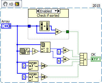

Doesn't this meet your requirements ? Is it not efficient enough ?
I didn't make a benchmark to check if it would be faster to start the search of 3 at the index of 2.
Message 7 of 28
(10,304 Views)
On my quite old machine, check if sorted disabled : 5ms for an array with 10M values and 47ms with 100M.

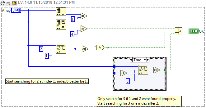

@JB I like it.  You could use the delete from array to get the last element, at one point that was more efficient.  Also I think an improvement could be to start the 2 Search at index 1, and start the 3 search at the index 2 was found +1, but only if 1 and 2 were found properly.  If they aren't then we don't need to search for 3.
