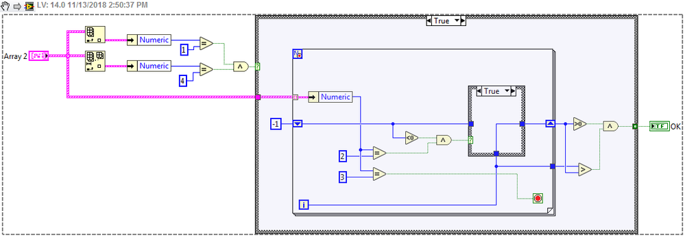

Here's a quick draft (LabVIEW 2015). A few microseconds (1-3us) for 10M million elements of an array containing a cluster with the "interesting number", three other random DBLs and a short string.
(Sorry, the data generator ran out of memory for 100M but the analysis should still be in the low microseconds. We need to simplify the cluster for larger sizes...)
(Some things could be tweaked and there might be edge cases that need to be addressed. No failure for Size=1k and >1M trials: looks promising....:) The innermost case could also be wired directly to the number with one case "2" and the other "default"))
(Note that the data generation is significantly slower that the validity check. It takes about 10s to generate the 10M array ... 🐵

My implementation (LV2018) is very similar to CA's except I used an enum to track progress.
I haven't tested yours because my data input structures are different, but one thing to remember is that any case structure with more than two cases is measurably slower than a case structures with only two cases. Your stack of case structures has 15 possible paths while mine only has four possible paths. (Yes, my outer case has 3 cases, but the code is so fast it does not really matter).
I am curious what the performance would be.
Message 19 of 28
(6,882 Views)
Christian and GregS, y'all rock! Your algorithms both work well for my situation. Y'all brought my processing time down from ~1 sec to 0.003 sec. GregS, since you conveniently posted a .vim, I just dropped it into Christian's benchmark VI to test its speed and functionality.
