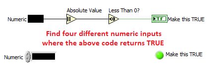

I guess we could have an occasional quick pop quiz that should post no problems to the seasoned programmer, but might stump some of the newcomers for a few minutes. So here is the first one:
QUESTION: Given the code shown in the image, find four different inputs that will make the output TRUE when the program is executed.
(Any numeric datatype is allowed, that's why the wire is currently a generic black. All primitives are straight from the palettes. No fake modifications or hidden custom code).

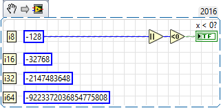

Since I was already privy to the discussion that prompted this, I will give a hint.
Spoiler
There is a value for each of the four integer data types (I8, I16, I32, and I64).

You said any numeric datatype is allowed, but that's not completely true 🙂
Broken wires are allowed, but it would be difficult to generate a TRUE (i.e. the required task!) with broken code. 😄

so i could do it for integers, not for floats, and i am quite confused.
i hope you will give a nice explanation
Spoiler
seems my twos-complement knowledge has shrunk to a peanut 😉
the absolute value of -128 is not representable in i8,
the normal operation would be to negate all bits and add 1,
but that doesn't seem to happen here.

jwcs,
Spoiler
Do the math in hex and it makes a lot more sense.  Take the I8 as an example.  -128 = 0x80.  Invert all bits yields 0x7F.  Add 1 and you are left with 0x80.

@crossrulz
Spoiler
thx.. as i said befor .. peanuts 😉 .. i read up on the twos complement now it makes sense and is the "normal" two complements way
