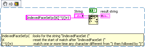

I didn't even think to try that, but it worked for me.  I just deleted the While Loop and wired the Boolean constant.
23794iFBC83965123EF33A
Have you right-clicked the node and checked "Regular Expression"?
23796i1AF387017E031FD7

d'Oh!!!
I wasn't using the Matche Regular Expression!!
I was using this one!
Well, it partially worked...  😉

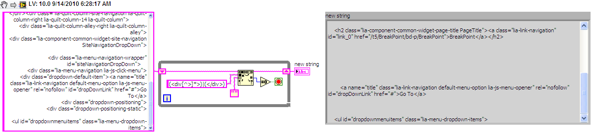

I needed to process a bunch of old TestStand 1.0 and 3.0 HTML reports for import into a database. I thought, what a great way to learn regular expressions!
After some research, I kept reading "you can't use regex to parse HTML". Since I had structured HTML in two different flavors (basically out of the box reportgen_html and a couple of additions to the header) I tried anyway and came up with this. I had to parse the data further, but that was specific to my application. This VI was used to clean the HTML tags.

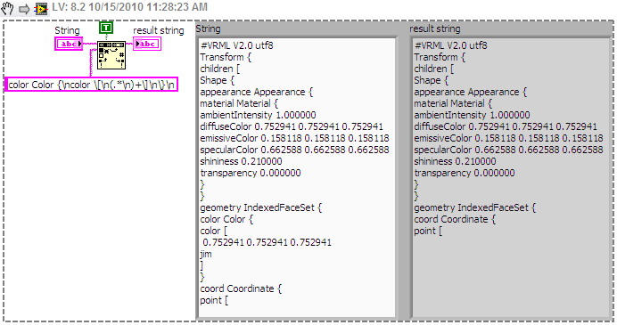

See here for an example to toss bad nodes in a VRML file.
Two solutions offered are;
and
