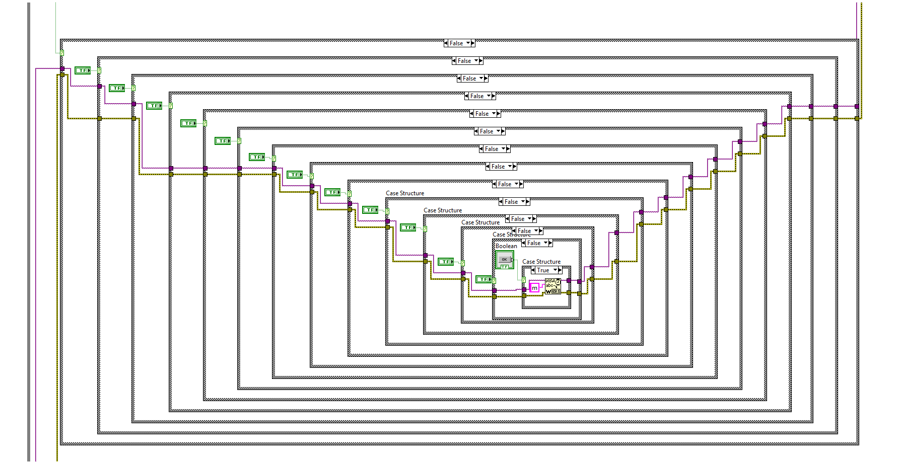

@Yamaeda wrote:
Sweet lords and demons!
Wow!I think it is safe to say that the code could be rewritten so it fits on a postage stamp!
It currently has anything, including 14 tier Aztec pyramids, the opposite of boolean logic, and incredible duplication of operations. 😄 How many times do you possible need to take the same subset of the same string in parallel (see image), just to compare with a different string for each subset. (I wonder if the compiler can eliminate the common subexpressions here :o).
Message 1333 of 2,635
(12,952 Views)
Yes, it also has Rubes in the form of 'x AND true-constant' and the works. It's actually impressive to get that many RGC's in one VI. 😄

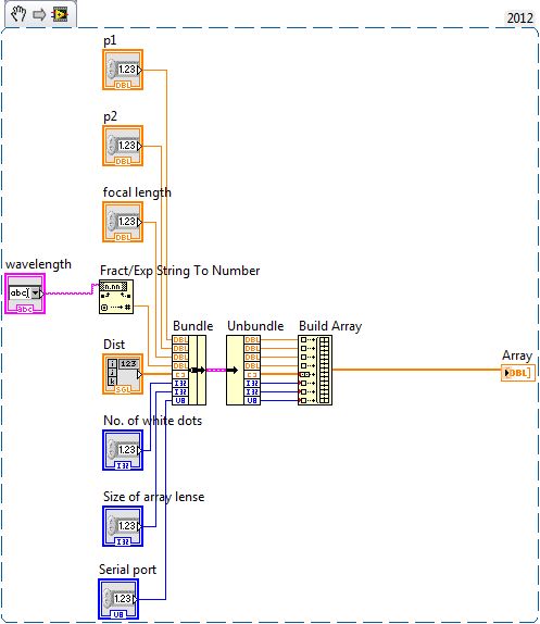

Long time listener, first time poster.
Entry level Rube, I guess, but it tickled me. Found here.
"I want to store lots of numbers using Write to Spreadsheet File. It takes 1D/2D arrays. Let's see... I'm going to bundle them together. No, wait - I don't need it in a bundle, I need an array! Let's unbundle them again and then build an array from the same inputs!"

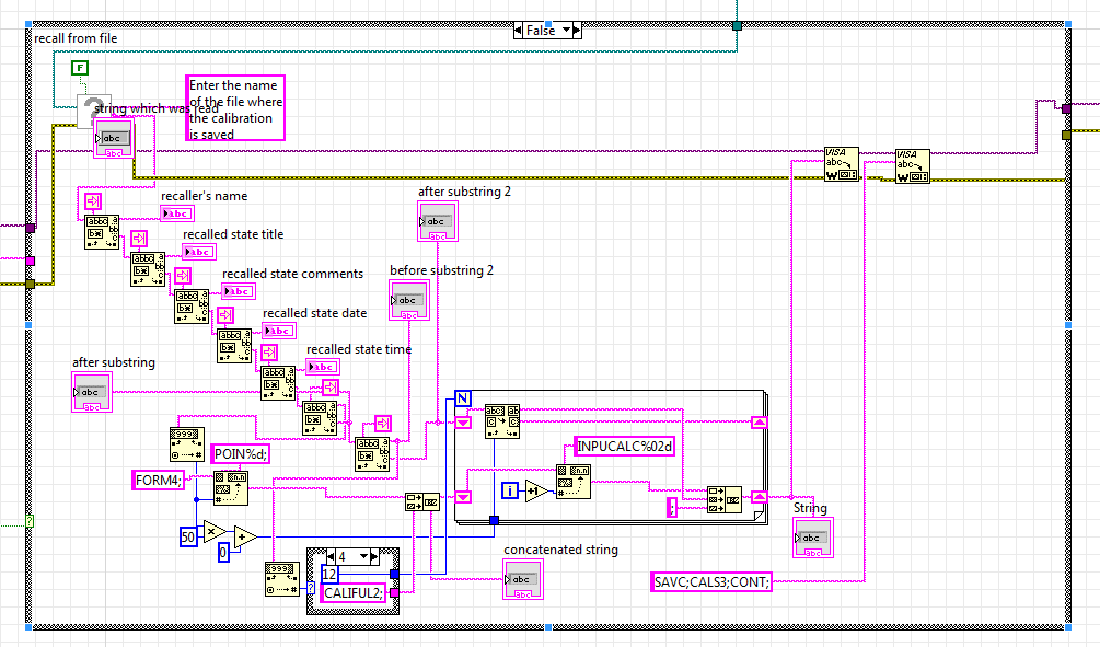

This Rube was spotted here.
Also, I've attached the VI.
[EDIT: Well it seems that I cannot send the .VI. Please change the attachment extension from .txt to .VI.)
Regards
Mondoni

A proper Scan From String or Spreadsheet String To Array would make that so much easier.
