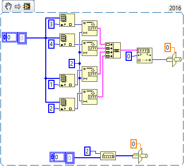

I ran into this one in some legacy code I inherited.  It was to convert data coming back from Modbus into floating point...
Message 1797 of 2,635
(10,916 Views)
Careful.  Notice that the 0 index was not used.  So you need to delete that element before you rotate.
Message 1798 of 2,635
(10,910 Views)
You are correct, sir.
The lower snip came from my code.  I'm using a newer Modbus package.  The old one returned an array of u8 with element 0 being the number of bytes per data point.
The new one just returns an array of u16.  I should have modified it to be identical before posting though 🙂
Message 1799 of 2,635
(10,902 Views)
If you have an array of U16, then you only rotate 1 element.  Or you could use Reverse 1D Array.
