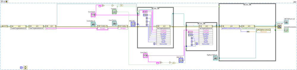

I've sadly also met my fair share of horrible drivers. A lot of what I encounter are DLL wrapped VIs. Lately, though, I'd be happy to see that vs some of what I have been seeing lately.
For example, the latest driver I got has this "Init" function:
It requires passing in references to controls I don't use, need to know internal of which port is RS232 vs RS485, and Comport and MacID per connection.  (Among other Rubes).
In fact, the "driver" is just 4 VIs, Init, Status, State, and Main (Demo VI)
At least the error chain is unbroken!  You should have seen what this looked like before.
And it used "VISA.User Data"  That's a no-no  (Waves finger /\/\//\/)
User Data clears before the vi calling it goes idle (Not saved by VISA as part of the session that you may not need to explicitly open)
Oh, that sad and lonely Wait function at the left bottom... 🙂

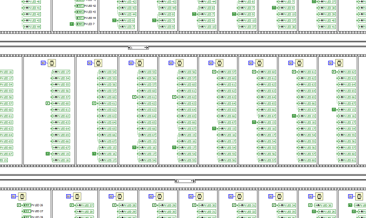

Let's really complicate the creation of an array with what is really a 1-D array at the end of the day.
Seen here.

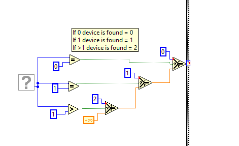

Hmmm... It's exemplary for the rest of the thread (and code):
Message 1946 of 2,635
(11,012 Views)
1. Write LabVIEW Code
2. Find less than 0 devices
3. Get infinite devices!
4. Profit $$$

@Gregory wrote:
4. Profit $$$
In his defense...
Spoiler
I regret it already (FRA 285)...
Only case 1 and 2 did something, 0 was default... (That extra info makes the code less wrong, but 100% redundant!)
