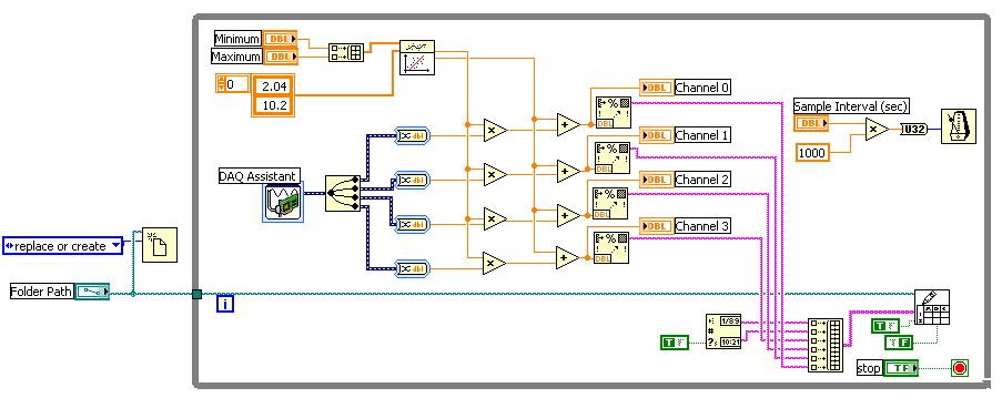

Dennis Knutson mentioned the Rube Goldberg post for my VI saving data to a text file. I saw his solution to my problem, and agreed.
It is still more than twice as complicated as needed. You have 4 trains of duplicate operations and, unless you are worried about muticore optimizations, you could use a FOR loop.

This may not be the place to continue correcting code but I really don't like the idea of using any type of wait function in a while loop to control when operations are done. I see this over and over but what happens if someone wants to kill the program right away but they are taking data every 10 seconds with the way this is coded? The user hits stop and has to potentially wait 10 seconds for the program to actually stop! Try using a case structure and possibly a countdown timer to your advantage to fix this. I'm sure there are many other ways also, if anyone else wants to suggest something.
You might want to start a new discussion in the LabVIEW board, because it is a general concern.
Problems occur in poorly desinged code with deeply stacked while loops and excessive use of sequences, for example. A well designed state machine will never have such issues.
You are right, hard waits should typically not be used for anything longer than fractions of a second, and ther are plenty of alternatives (such as events with dynamic timeout recalculations (example) as discussed here). A program needs to be able to react to user input, including stop commands, at any time. If you get long stalls, you're definitely doing something wrong. I don't think there is any literature that suggest to use long waits.

I have since posted an updated VI using an event structure for timing instead of the wait until ms multiple.  I used my original post here.
