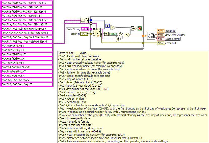

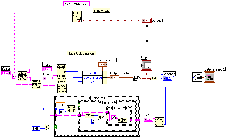

I saw this thread and it is funny. I found one of my old ones in here. I was put together to do something spacific. I have since revised it. Hey raven thanks for busting my chops.
Here is the new way.
So ravens you want to bust my chops some more on this one too?
Actually, I was the one busting your chops on that one. I'll let Ravens Fan bust your chops on the new one. Smiley Wink
Message 556 of 2,635
(12,371 Views)
That's an interesting one.  I'm trying to figure out what it does.  My guess is that it takes some arbitrary date/time string and runs it through the wringer until it finds a date/time format that successfully converts it to a time?
Does it work?
How about the %Y options?  I would think the last element where it was a full date,  would use a 4 digit year.  So Saturday, October 17, 2009 makes more sense then Saturday, October 17, 09   Smiley Very Happy

Yes it works. It itirates through all of the accepted string formats for data and time to output the date time numerice date time stanp etc...
What do you see that is wrong with this one?
