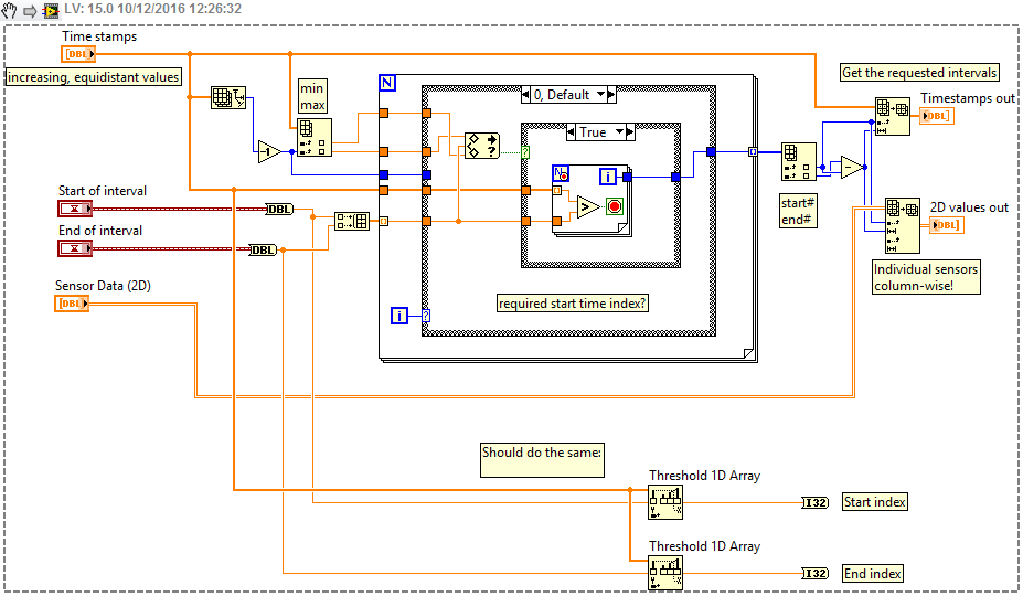

I am revising some of my older projects, and I have found this... actually I did not change that much, I am still very vulnerable to end up with Rube Goldbergs 🙂
Message 1775 of 2,635
(10,741 Views)
You probably want the Ceil(Index of threshhold) for Start and Floor(Index of threshhold) for end to be an exact dup of the code above
Message 1776 of 2,635
(10,708 Views)
Yes, thanks.

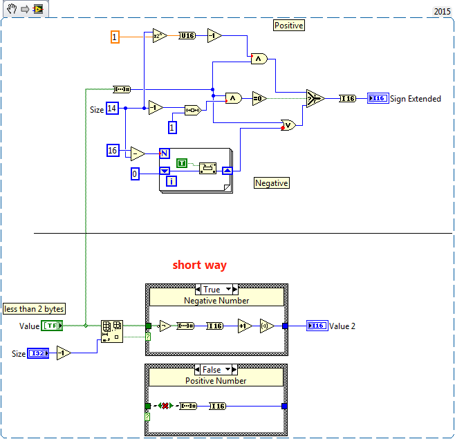

I found this code in a review, the idea of the original code was to build the complement of two from a number of bits less than 16. The programmer did it in a really hard and not modular way.  Im not shure if it works for every value...
Build two's complement
Probably there is even a more simpler solution...

I don't think the two code fragments are equivalent, because the lower code depends on a size input, while the upper does not.
Message 1779 of 2,635
(10,590 Views)
There's a constant size 14 in the upper one.
/Y
