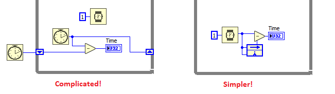

Yes, these day "real benchmarkers" use "high resolution relative seconds", but for those still using tick count differences in a loop with a wait here's a tip to measure and verify the loop time (e.g. to ensure that the code can keep up!). The wait primitives give you a tick count output, no need for all that extra code!
(Nobody but me seems to ever use that! A similar tick output is also from the "time" event data node available in all (or most?) events. Useful!)

I use feedback nodes so seldom compared to a shift register.  But of the times I use a feedback node 90% of the time it is for simple timing like the example you gave.
(see also)
Awesome info!
- Partha ( CLD until Oct 2027 🙂 )

Of course there are build in functions for getting the derivative.
And it keeps working if the iteration time exceeds 49.7 days! (Smiley Indifferent)
Getting date/time is more expensive and if you look inside the ptbypt deriv, it's a bit ugly, containing an obsolete VI just to get error information on init (validity of dt and initial condition values). Then it has three shift registers. compared to one. 😄 It also does not follow modern guidelines on terminal placement, having some deep inside structures. All terminals belong on the toplevel diagram here. (e.g. "error" should be kept explicitly in a SR, not carried in a stale indicator. IMHO)
That's why I typically use "high resolution relative seconds" I think it's more lightweight, not sure. It also does not need that lossy conversion from timestamp (128bits) to DBL (64bits). 😉 I don't think you need the "=0" because it inits unconditionally on first call anyway. You also need to wire the time to the initial condition, else you get garbage values for the first two iterations.
wiebe@CARYA wrote:
Btw. time to make those PtByPt's a .vim.
.Agreed. At the same time the code should be cleaned up a bit. 😄

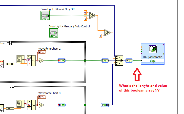

In case you did not know how to create a simple 1D boolean array, here's one way I don't really recommend. 😄
(seen here)
Message 2006 of 2,634
(11,253 Views)
Especially the conversions in the two case structures which (I think?) take a boolean, coerce it to dynamic data to then cast it to a boolean array, then back to dynamic data, merge it with other signals and back to a boolean array.
I also strongly dislike dynamic data because what even is the expected output of a double casted to dynamic data then casted to a boolean array.
Prime example of why "Express VIs" shouldn't even be there and "Dynamic Data" should be introduced at a much higher level.
NI is doing a huge disservice to new programmers with their "Just take these Express VI's and connect them with Dynamic Data wires so you don't have to worry (or think) about data types, how to properly handle them, or what you are doing.", beginner tutorials.
(seen here)
I THINK There is a clue to the poster's thought process in the boolean control labels.  We don't really need to ask, " What have you been smoking?" do we....
Message 2009 of 2,634
(11,236 Views)
My office is temporarily offline for movies but,  aren't the block diagrams unlocked.  WARNING: some content my offend some viewers.  Discretion is advised.
