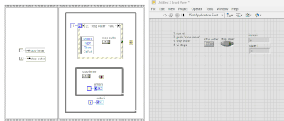

If an outer while loop contains an event and another inner while loop and  both the event and inner while loop are separate, then is there any possibilty that the execution comes out of the inner while loop when the event occurs and after executing the event it comes back to the inner while loop where it was previously executing,

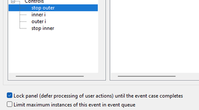

Did you turn off the "Lock Front Panel Until Event Is Handled" for both of those controls?  It looks like an extra button press is locking the front panel since the Event Structure is not being handled due to the extra loop inside of the loop.

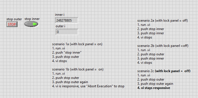

no, I didn't uncheck Lock Panel, which is checked by default (scenario 1)
Spoiler
when unchecking that flag AND saving the .vi (scenario 2)

Why aren't the buttons latch action?
Why is the an timeout case that can never happen?
Why is the inner loop greedy?
Why is there a sequence structure?
Message 2578 of 2,634
(1,398 Views)
- because you can't use local variabels with that mechanical action
- because, I don't want any timeout effects, can it be removed?
- because it was suggested by the OP
- because I use local variabels, and want them to be executed first
