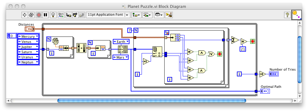

After more than a year, I'm bringing this thread back from the dead!  If you're a GAMES magazine subscriber, then you've already received the February 2010 issue that has the "Starstruck" puzzle on its cover.  For those of you who haven't seen it, you have to get from Earth to Mars in 21 days, visiting each of the other six (sorry, Pluto) planets along the way.  Each planet has a path to each other planet, but the travel times vary.  I would post a screenshot, but I don't want to get sued for violating copyright.
Anyway, I stared at the puzzle  for half an hour over dinner tonight, and after coming up with solutions that were 22 or 23 days several times, I decided to be a nerd and write a VI to solve it (instead of just flipping to the solution):
Yeah, I own a Mac (mini).  Big whoop, wanna fight about it?  Anyway, it's a brute force randomized approach, but I found that it took anywhere between 1 and 10 milliseconds to run each time.  I've attached it below (saved in 8.5).

Cute!
This is one of these problems that get out of had very quickly with the number of stops. (O(N!)), but 6 is trivial. 😄
Have a look at some of the strategies on the Wikipedia page of you want to solve much bigger trips.
