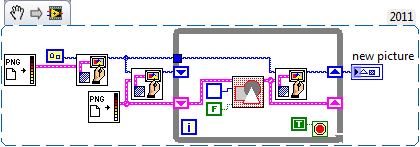

Here is one solution:
If you would like to make your own I used this site:  http://leemon.com/crypto/VisualCrypto.html
And no I did not pick the font, but I did pick a size that would be hard to print out and see on a sun lit window.
-SS

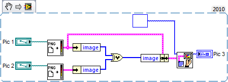

Oh come on now. The work can be as easy as this:
At least, that's the way I did it. Downloaded the two pictures and then just loaded them and XORed them.
But then my first test was to load them into GIMP with the second picture used as a mask for the first (XOR).
Do you really need the while loop that only runs once?
Rob
Message 116 of 192
(3,807 Views)
Rob's snippet is more like what I did to get the answer.
What I found interesting is that using AND also gave readable results.  So did using OR.  That kind of surprised me.  Must be something in the algorthim that dithers the pixels.
