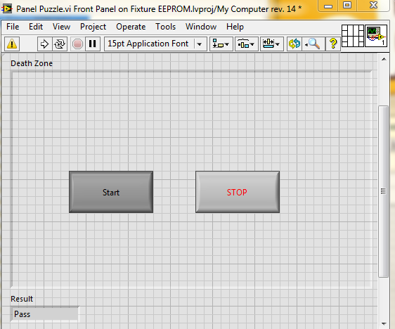

Saw a similar puzzle to this once and replicated it in VI form. The solution is fairly outside the box.
Run the VI then click start. Try to find a way to click stop without failing
No altering the VI in any way (properties, bd, fp, etc).
I want to know if people solve it in other ways, so maybe put a spoiler tag. There is a non-coding way to do this, and I'm sure the gurus here will find a way to beat this with LabVIEW. Either way, Kudos.

Here are some options:
Spoiler
  1. Press Ctrl+.  This will stop the VI, but that's not the actual requirement of the challenge.
  2. Tab to the stop button and press Enter. This also won't work because it wants a mouse down.
  3. Go through another window. This won't work because of the mouse leave/enter events. That also rules out other kinds of move-the-window-so-that-the-button-is-the-edge options.
  4. Use a touch screen. This will work, but I'm guessing that's not the solution you're looking for (or maybe it is)?
  5. Use the OS API to move the mouse directly to the other button. This will work, but it requires code.
  6. Use two mouse cursors in the OS and place the second on the stop button. As far as I know this is possible, but I'm guessing that's not what you meant either.

Yes, I should have said click the stop while the VI is running and trigger a pass. I imagine people will easily find a way to break that too, so I'm not changing the rules. Either way, very nice, I didn't think of the last three.
Spoiler
I was actually thinking people would find a way to trigger a mouse down event.
#3 was the solution of the original puzzle that prompted this. I was going that route when I realized there was no easy way to program it. Instead, I found a way to solve the puzzle that I inadvertantly made.

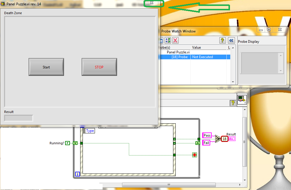

Spoiler
Click the windows X.  Fail does not appear.  vi stops. solved. (The FP Leaves memory before the UI updates with LabVIEW 2012 With Highlight execution on) Or did you mean I need to generate a "Pass"1!.PNG
