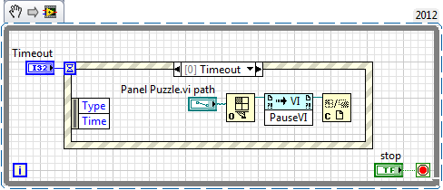

More than 1 way to skin the cat:
Spoiler
1a.png Instructions included
