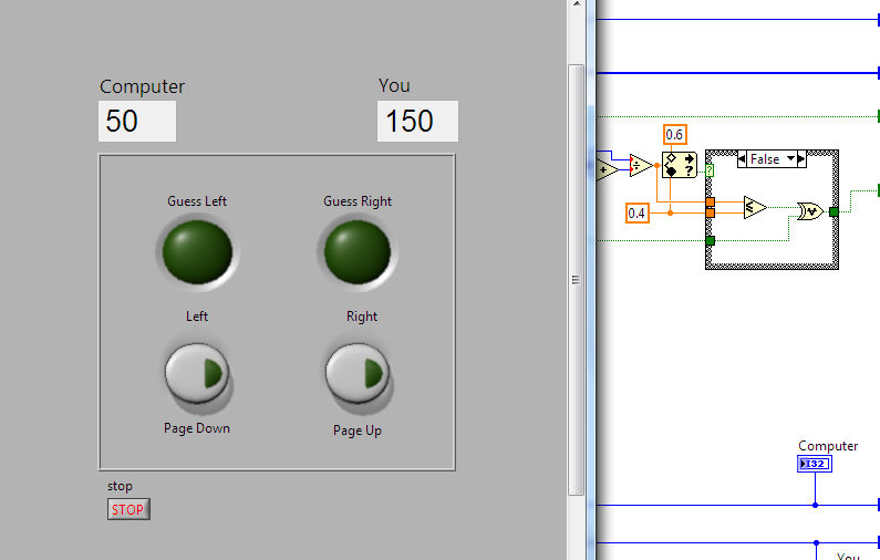

I think this qualifies as a "win"
My stratagy was to click left 4 - 5 times then once on the right, seemed to work well.
Nicely played, now you are ready for the next phase.  Change the 0.51 and 0.49 to slightly higher and lower values respectively, say 0.6 and 0.4 and try again.  This adjusts the amount of time the computer spends randomly guessing.  As I set up this time it quickly jumps on patterns and gives you a chance to "trap it".
When that is thwarted, then I unleash the second order version (this is a simple first order one).
Message 144 of 192
(4,532 Views)
It changed plenty more, so I revised my strategy to click the right 2-3 times then once on the left.
Seemed to work just as wellSmiley Happy
Looking at the transitions tracked now, the simple version catches the pseudo-random opponent, not the unrandom opponent.  I think the higher order method I am thinking about will stop the unrandom opponent.  And now I also see why the actual game was to actually compete in a game of heads or tails.  You try to guess the result of a coin flip (or other 50/50 proposition), and the computer tries to outguess you.  This forces you into a psuedo-random pattern and it comes down to who is "more random" which the machine normally wins
In reading the literature, the expected results when knowing the computer's method is about 65% win pct, so your 75% is not unexpected.
I'll probably try the coin flipping version now, and then adjust this one to take higher order transitions into account.
