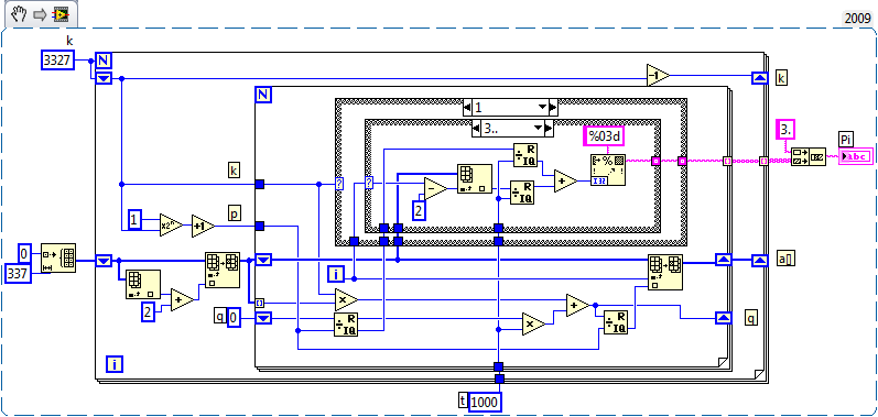

In case anyone wants to see a G implementation of the Pi spigot C code:
long k=4e3,p,a[337],q,t=1e3;
  main(j){for(;a[j=q=0]+=2,--k;)
  for(p=1+2*k;j<337;q=a[j]*k+q%p*t,a[j++]=q/p)
  k!=j>2?:printf("%.3d",a[j-2]%t+q/p/t);}
Mine is faster (spitting out 4 digits at a time) and actually includes the 3 in the beginning (notice how I had to tack it on).
Some annoying abuse of the ternary operator there, along with the comma operator, and I rarely put more than my increment/decrement in the third slot of a for expression....
