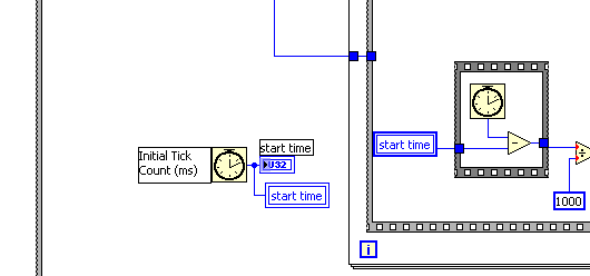

Ooo!  Ooo!  Ooo!
Here we not only wire to both the indicator AND a local variable of itself, we also have ANOTHER local variable sitting right inside the loop!
Spotted here.
Message 168 of 396
(8,121 Views)
How helpful is this suggestion??? (compare with the actual question!)
Message Edited by altenbach on 03-19-2010 01:35 PM
Message 169 of 396
(8,071 Views)
I am sure AndyC was just showing how to to use the property nodeSmiley Very Happy
