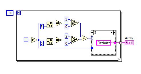

A nice task I hope I solved without any Rube Goldberg codeSmiley Happy
Even

Mine was similar:
Spoiler
Jim

Spoiler
Greetings from Germany
Henrik

Henrik,
This is not a code obfuscation contest!  😄

I haven't tested it for speed, however I wanted to avoid two quotient&remainder vis  😄
How about a one line regular expression someone?

Mine's v.similar to jcarmody's, but slightly more convoluted thanks to the select VIs Smiley Sad
Spoiler
I was referring to your first solution.
Don't be :(.  You just beat 199 out of 200 people applying for a programming job.  🙂
Still small thing you have that kind. You could have used Equal2Zero.png instead of Equal2Zero - 1.png. Smiley Wink
