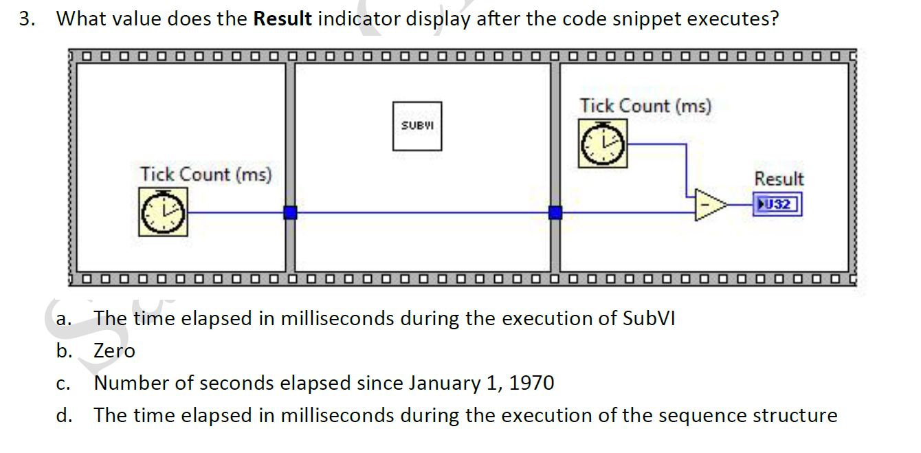

Anwer B and C are clearly wrong.
But I am not sure any of them are right but if any Answer D seems the nearest to being correct.
So why is A the correct answer, surely it's not during the execution of SubVi but the elased time of the execution of SubVi

To get the timing of the sequence structure, the ms timers would both need to be outside the structure; before frame 1, and after frame 3. As it is, the timers will only time the middle frame.
EDIT:
Although, if we make the (rash) assumption that there is nothing else on that block diagram, then the subtract operation and the count VIs will take a few CPU flops each, and both answers A and D would be expected to be be the same number

I get what it's timing. But it's not the elapsed time during the execution of the SubVI as the SubVI would of had to finish to get the elapsed time.

I had to re-read all of that several times before I figured you were querying the word "during". My brain is terrible for skim-reading and making assumptions.
Yes, I totally agree with you. As worded, all 4 answers are wrong. The Result indicator would show the execution time of the second frame.

Great catch! and thanks for reporting the error. We will have the sample exam corrected and posted as soon as possible.
Zaki Chasmawala - Certification Development Group Manager

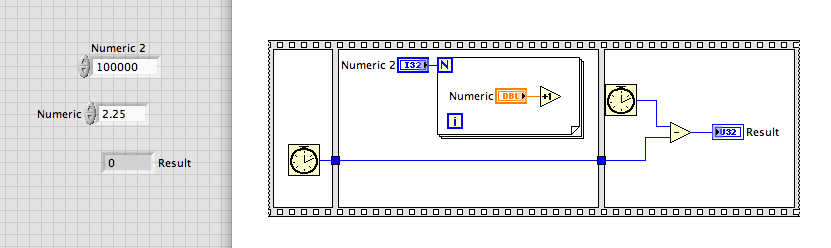

Of course answer b could be correct also if the execution time of subvi was significantly less than 1 ms.  The code shown below has a zero result more often than non-zero with numeric 2 <= 100000.
Lynn
Message 6 of 14
(10,468 Views)
Lynn
Lynn,
Looking back at this example the 0 is expected.  no output from the for loop is used the dead code removal optimization should kill the loop so that the compiled code would have no loop and simply read Numeric and numeric 1 once each.
Message 9 of 14
(10,413 Views)
Jeff,
You are right.  Even though my hasty example may be irrelevant, answer b (Zero) may be right for many real world cases.
That makes this another case of a poorly worded question, or at least, answer set.
Lynn
